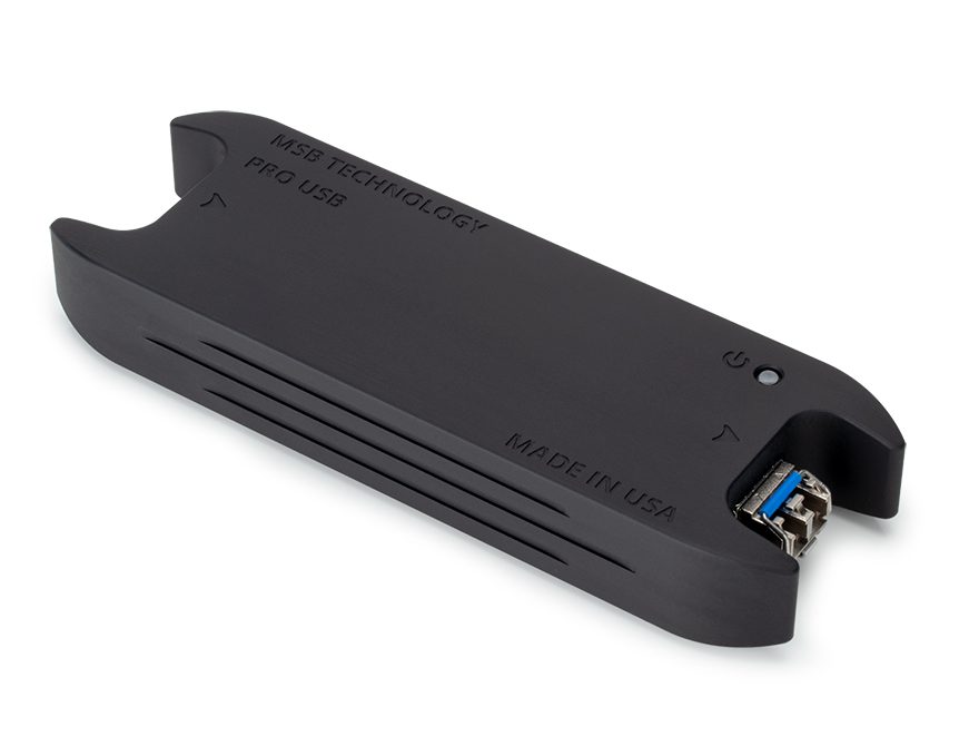

Pro USB Identification
The Pro USB is not an input module. It is a multi part USB solution that is not installed in your DAC, but is an external module as shown below.
