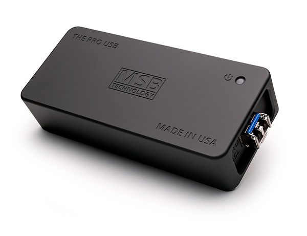

Pro USB Firmware
Pro USB
This firmware is for the Pro USB option that is compatible with the Discrete, Premier, Reference, and Select DAC series.
