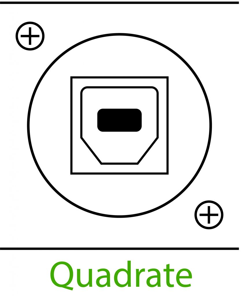

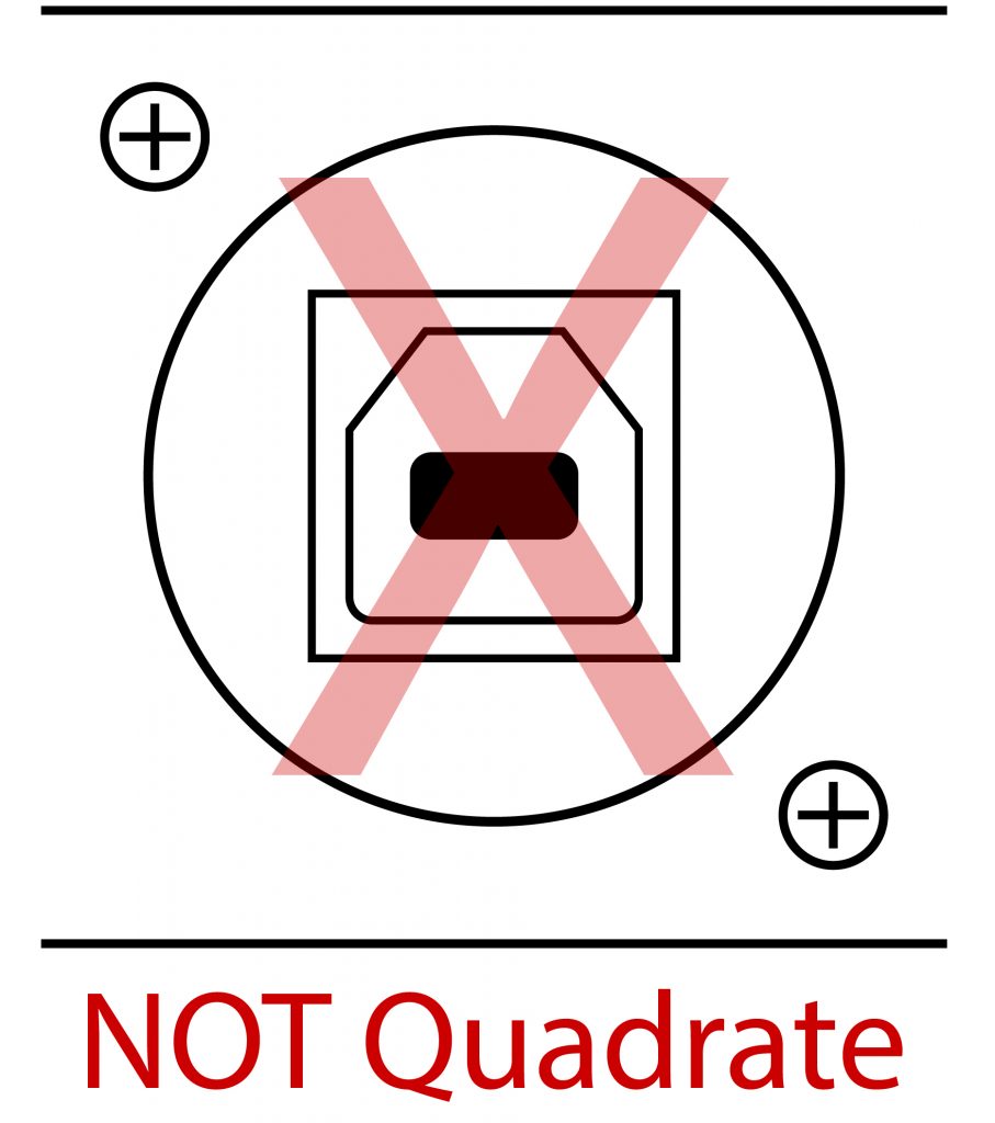

Quadrate USB Input Identification - DAC IV, IV+, and V
While observing the jack panel of your DAC, take note of the shape of the inner most part of the USB connector. The inner most part of the USB Type B connector forms a small “D” shape. If this small “D” shape faces down, then your DAC is equipped with a Quadrate USB Input. If the small “D” shape is facing up then DO NOT install the Quadrate firmware. The USB Type B connector can be found in “AUX 1” or “AUX 2” of your DACs jack panel.
