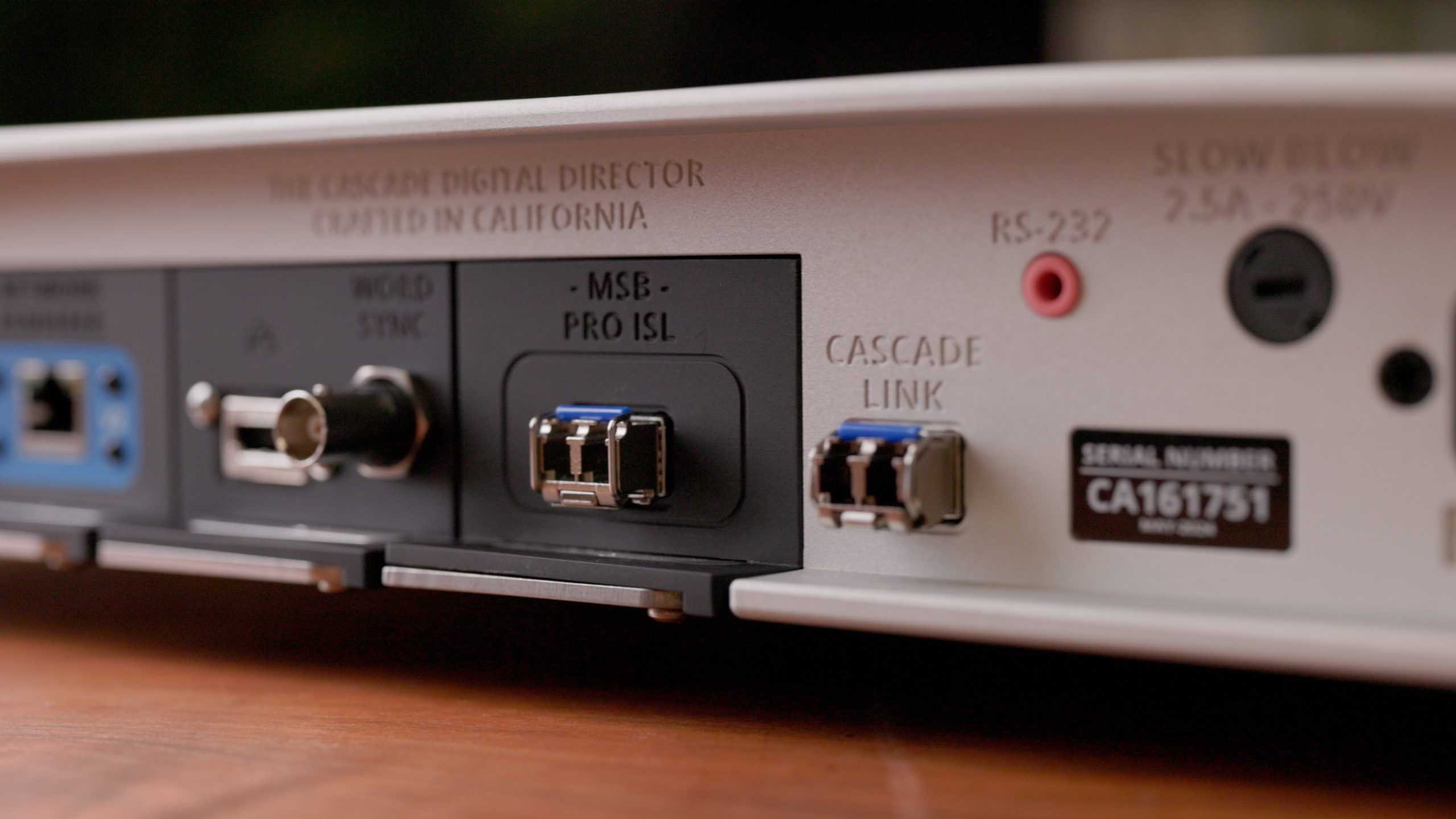

Fiber SFP modules are hot swappable. That means you can experiment without powering off equipment, but you must exercise basic ESD precautions. Before touching the SFP module, always ground yourself to the chassis with your other hand.

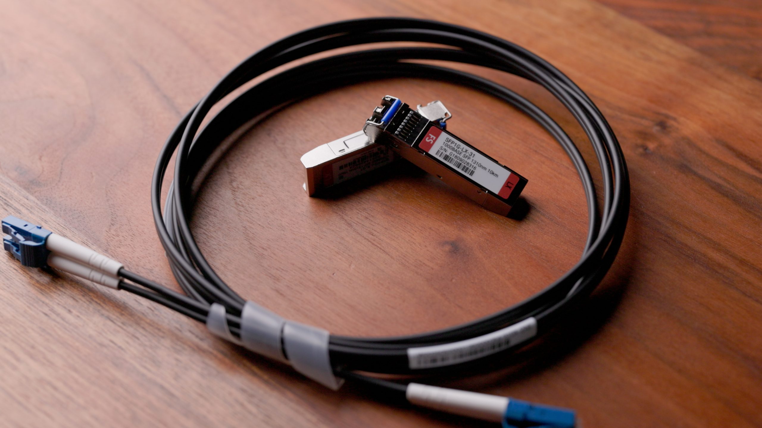

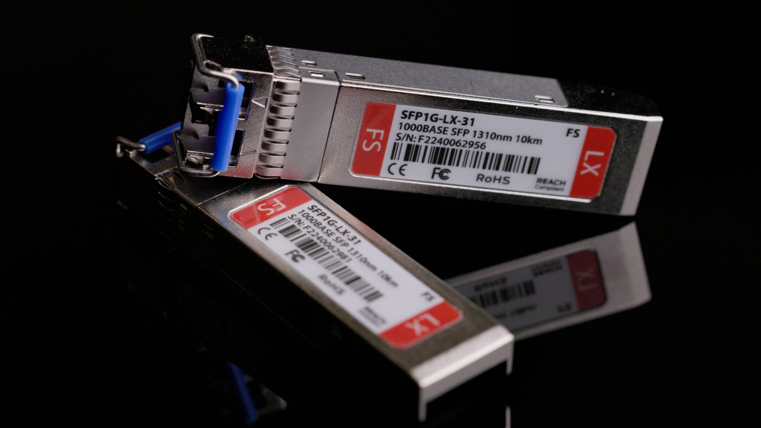

Let’s first explain the stock configuration. Every DAC ships with two matched single-mode SFP optical modules, already installed. There will be a single-mode duplex LC fiber patch cable to connect them. This is a tried-and-true reliable system. You can plug and unplug this fiber cable almost indefinitely, and if any part wears out, it’s easy and inexpensive to replace.
But it does require some care.
When handling SFP modules and fiber cables:
Make sure the connectors are clean and free of dust.
Always push the cable in until you feel the click.
And double-check the latch on the module is closed. Leaving it open can cause grounding issues.
We recommend using this configuration for those of you who like to A/B test cables, gear, or swap connections often. It’s durable, modular, and designed for frequent changes.

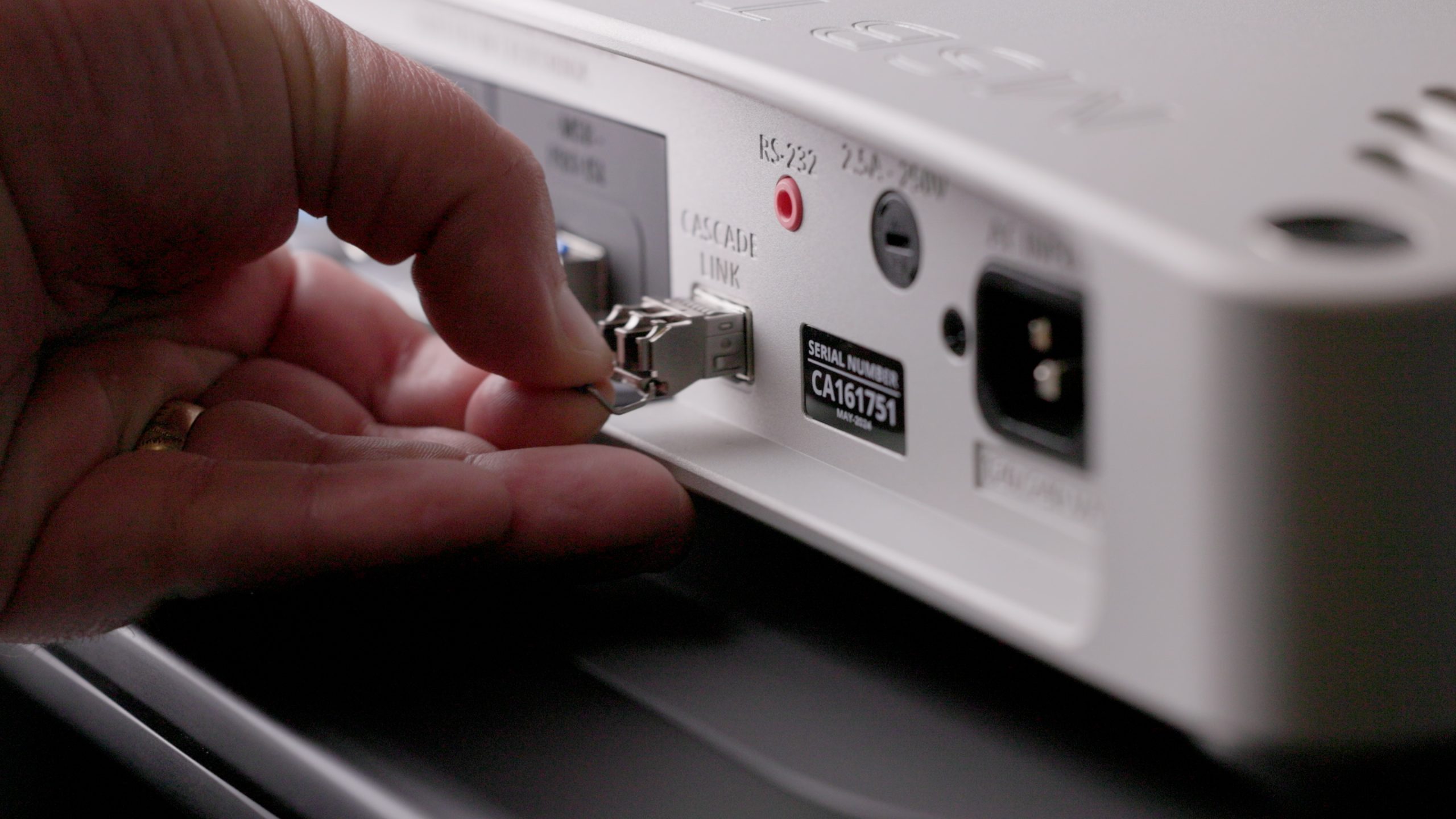

For removing these fiber cables, depress the plastic locking clip and pull the cable. When inserting the cable, make sure the lock audible clicks into place. Make sure it is firmly seated.

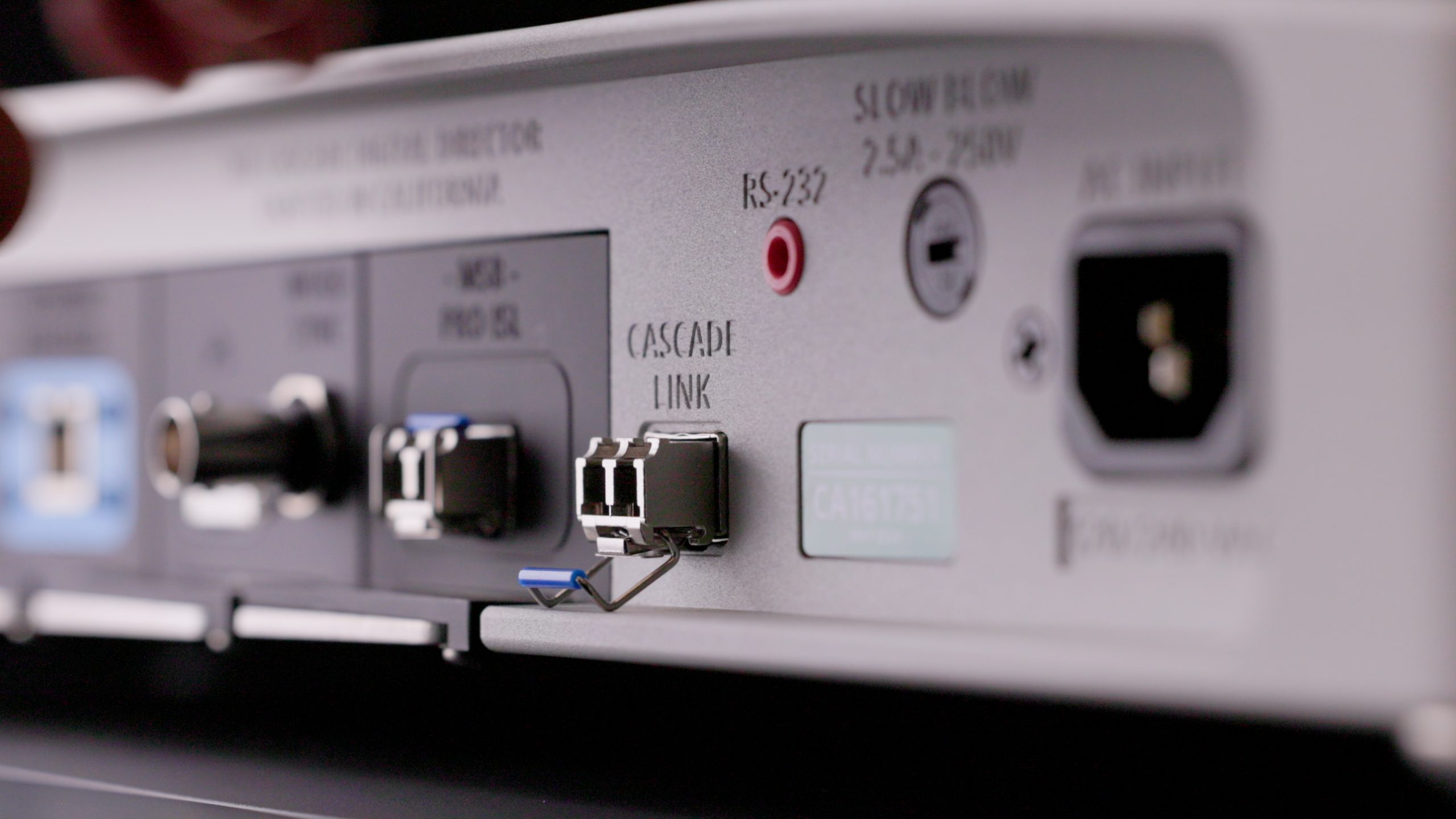

To change out the SFP modules, swing the removal lever out. This will disengage the locking mechanism and allow the SFP module to be pulled free. Pull the module out by the lever arm itself, not the body. If the SFP module is unlocked correctly the module should slide out easily with little to no effort. If it seems stuck… DO NOT force it. It is likely still locked in place. When inserting a new SFP module, make sure it is firmly inserted, then close the lever arm into its stored position. If this lever is left open, it can short the isolated connection to the chassis and will prevent the DAC from working.
Pull the SFP Module out by using the release lever.
DO NOT leave the release lever unlatched.

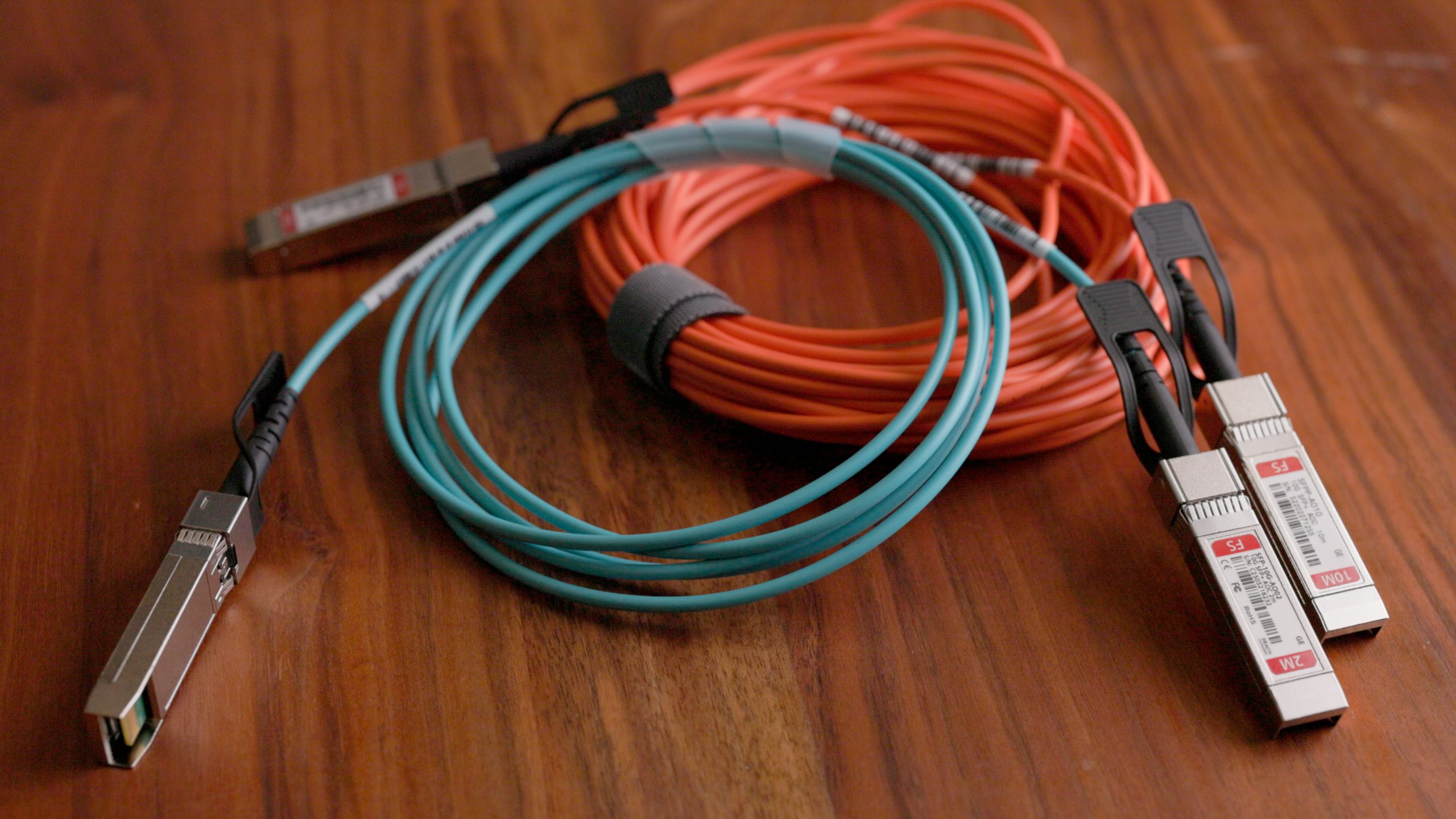

That’s where Active Optical Cables come in. An AOC combines the fiber cable and the transceivers into one closed system. No separate modules. No separate cable. A closed and perfectly matched system.
The simplicity of this system is key. You remove extra junctions with no mismatched parts, no dirty fiber ends, no half-seated connectors. This matched system can run at twenty percent reduced power consumption achieving further benefits with a lower noise floor. The cable itself is tuned for the specific laser light wave length and cable length and doesn’t need to overcome any air gaps.
While the results may vary somewhat by a listener’s system, the overwhelming response of our beta testers have consistently reported significant improvements using AOC on the Cascade DAC and Digital Directors alike.

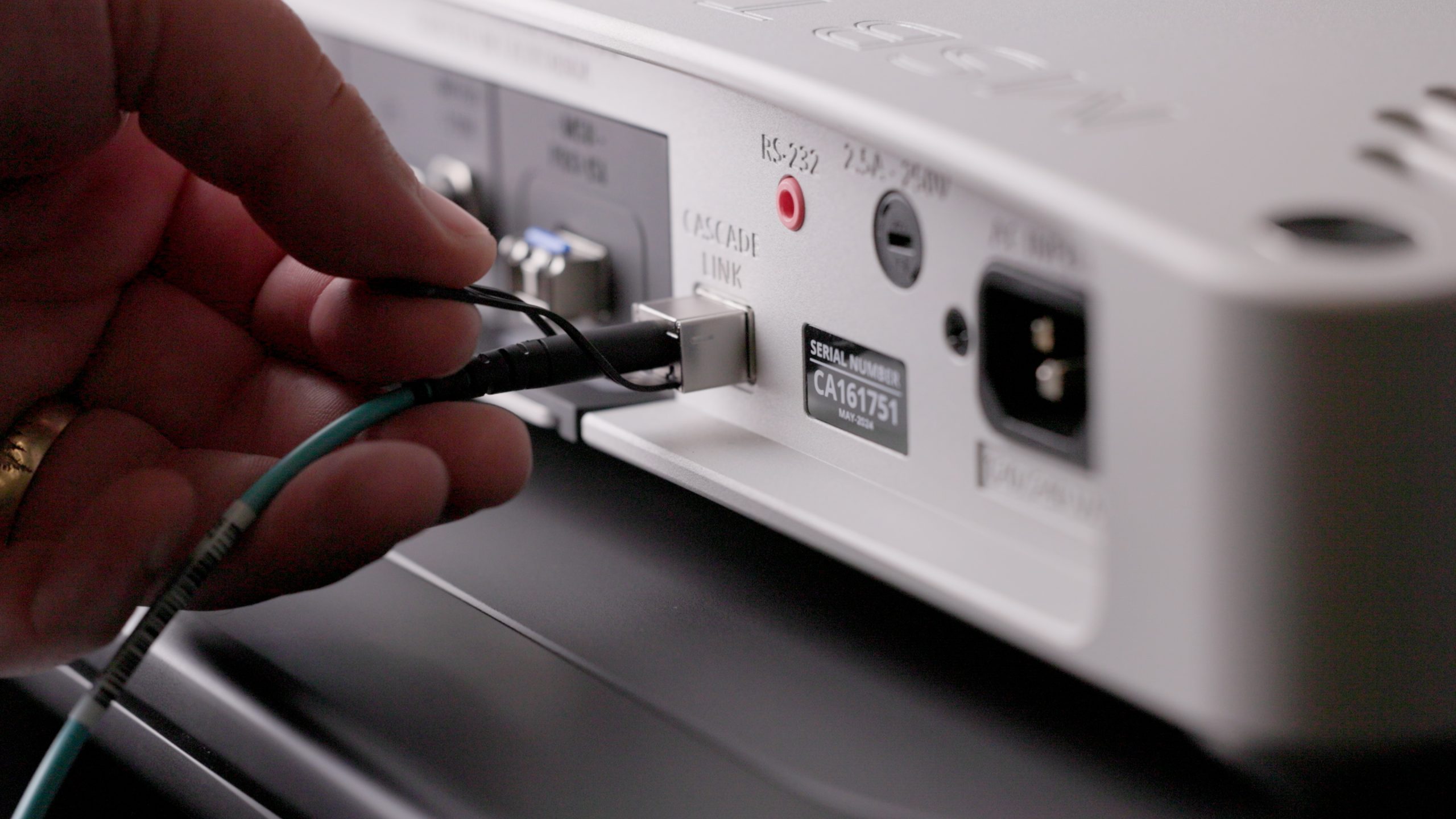

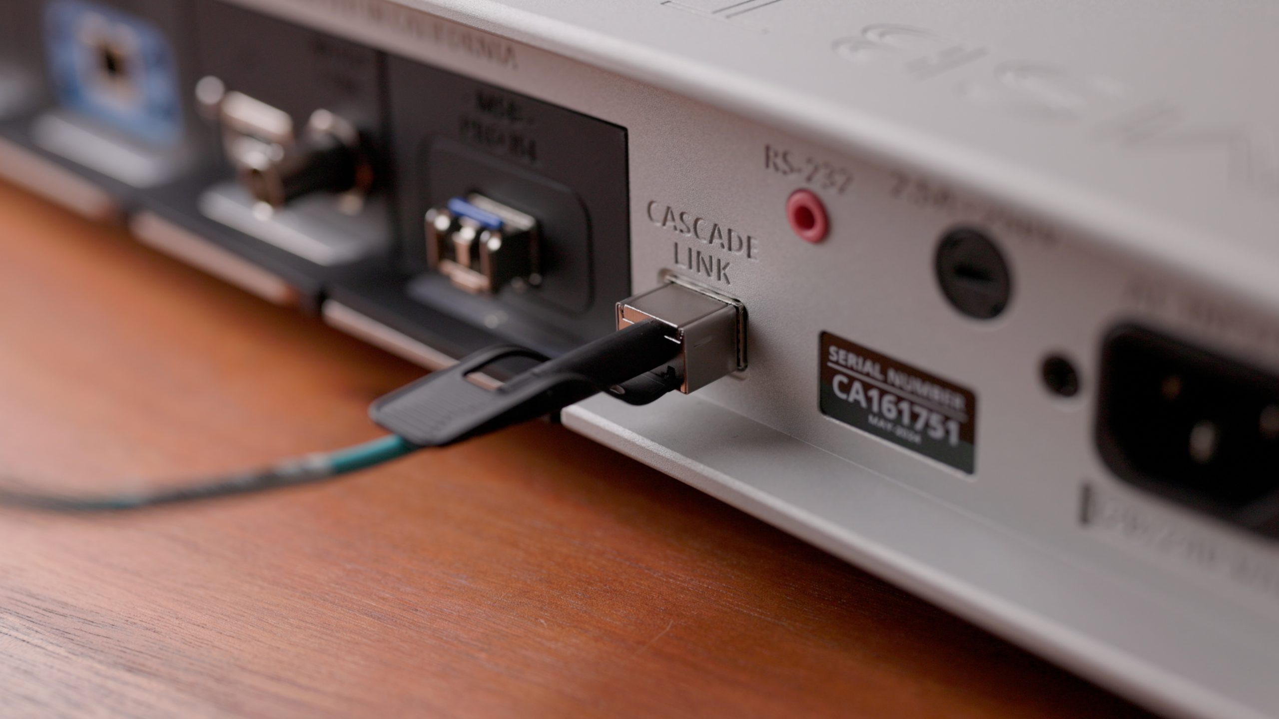

To change out the AOC cable, simply pull on the integrated release tab. This will disengage the locking mechanism while the SFP module pulls free. When inserting a new AOC cable, simply make sure it is firmly inserted and latched in place.
Make sure the AOC cable is FULLY seated when installed.
Pull the release tab to remove the AOC cable.

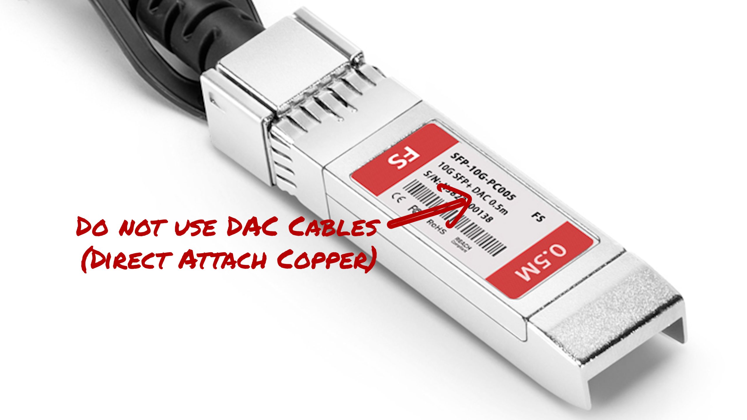

Do not use Direct Attach Copper cables — often called “DAC” cables.
They may look similar to AOCs, but they bypass isolation, can carry electrical noise, and will damage your DAC’s motherboard.
Another cable to avoid is called a “passive” cable. This is a hardwired version and will similarly damage the product.
MSB products are designed specifically for optical cables/transceivers only.

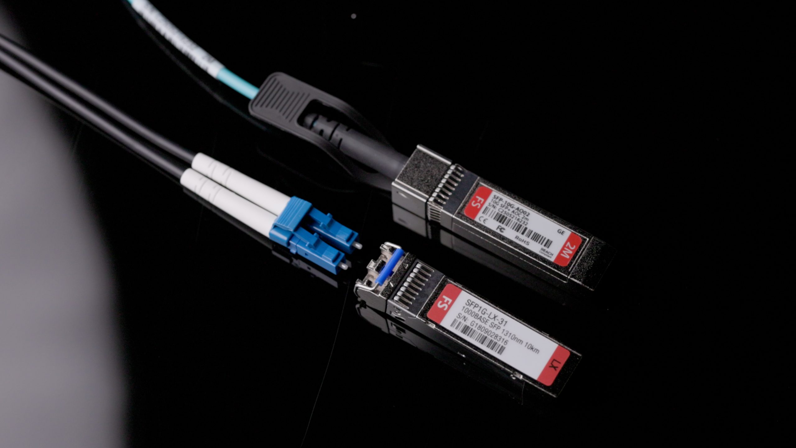

Below are links for MSB recommended AOC cables and SFP modules. The SFP modules and cables are direct replacements for the stock modules and cables that come with MSB products. The AOC cable listed below is the recommended cable that we will be making available through our dealers. It guarantees full functionality and playback of any MSB fiber products. However; a list of alternative cables and modules recommended by our community can be found on our the MSB Forum here.
Tips for choosing replacement SFP modules and cables.
- SFP modules need to be ordered as a set, and have the same module at both ends.
- The ideal SFP module will be single mode, which has the lowest jitter possible.
- Maximum power consumption must be under 2 watts, Ideally 1 watt or less for best performance
- The cable ordered must match whatever SFP module type is ordered.
- For example, a Single Mode SFP module should have a single mode Fiber patch cable
- The cable length needs to be a minimum of 2 meters or longer in length.
- We will have some recommended options included in the written guide.
Stock SFP Module - https://www.fs.com/products/75326.html?attribute=5939&id=4610587
Specifications:
- Transceiver Model: SFP1G-LX-31
- Compatible Brand: Generic

Tips for choosing AOC Cables.
- It must be 10 Gigabit SFP+ architecture.
- Higher-speed cables like 25G or 100G may work, but they’re not optimized for audio use and can sometimes reduce performance. They will use additional power and add more noise to the system. More isn’t always better.
- Length doesn’t matter for AOC cables — pick whatever fits your setup.
- Color doesn’t matter either — the orange and teal jacket colors are the same performance, it’s just an indicator for different manufacturing standards.
- And remember, any brand of 10G AOC should work. This is a standardized platform, so anyone manufacturing to the spec should be a compatible option.

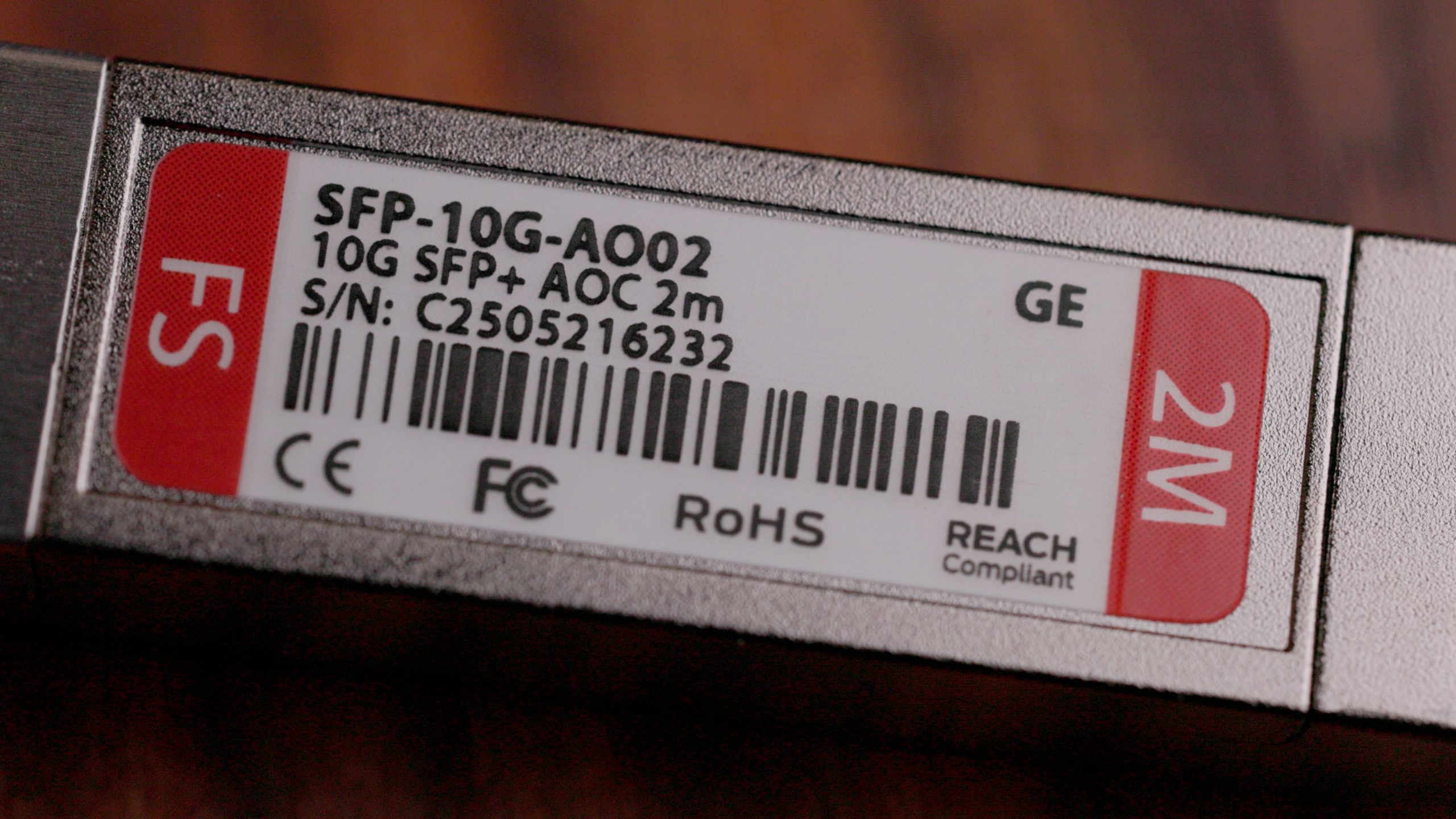

Recomended AOC Cable - https://www.fs.com/products/74607.html?attribute=10633&id=2101152
Specifications:
- Length: Any
- Compatible Brand: Any
